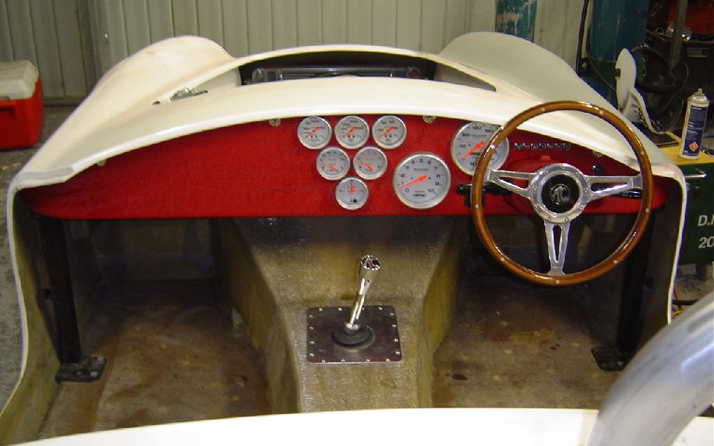

The modified shifter setup has a very positive acting reverse lock out. Unless it's engaged you can't even feel where the gate is. The shift action is short very positive and precise. The mod takes all of the mushiness and play out that the original shift setup can sometimes have. Aussie boxes have a diabolical rear mout sifter setup.
The shifter itself is stanless steel and billet aluminium construction and is a real quality piece.
I usually polish the lever and supply a billet alloy knob. The lever shown leans to the right for right hand drive cars but I can make ones that lean left or go straight up and down. I can also do a few other styles of lever i.e. a T bar gate style like the original Cobras.

To get an idea where the shifter comes out here's a pic of mine
http://www.clubcobra.com/photopost/d...Red_Dash_2.JPG
