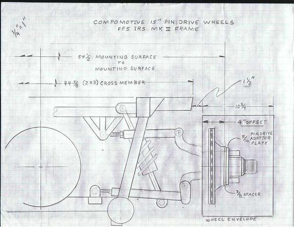

Does this sketch make sense?
Anyone with a FF5/IRS/Pin drive/Compomotive set up?
My wheels have comeback wrong twice, I need to make sure they are correct this third time. ( I did not call out the backspacing the first two times, the local distributor I ordered them thru made the call wrong twice, so I'm going to make the call this time)
thanks, Wayne Mac
