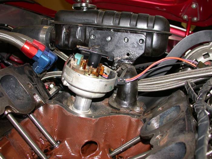

I put an FE expansion tank on my Cleveland.
The inlet neck had to be cut and pieced together in several pieces to get the right shape. I then had a Cleveland water inlet brazed to the end. I designed a new mounting bracket to pick-up available mounting holes of the front of my Cleveland. It also required some gyrations with my custom alternator bracket to clear the inlet pipe.

Hi Rick. I too modified a 427 overflow tank to fit my 351C. My alternator mounts lower than Jeffs, my upper pivot bolt goes into the front of the head and the adjustment bracket goes from the bottom of the alt to a lower water pump bolt. I used an aftermarket 90deg swivel billet thermostat/ block outlet and then proceeded to modify the tank. I cut the 427 flange and pipe off leaving only about a 1" section of pipe on the bottom of the tank, then used a 90deg section of rad hose to connect the tank to the block inlet.
I modified and reinforced the lower tank bracket to fit my 351C water pump bolt locations and to get the right hieght so I could close my hood (about 3/4" clearance).
I'll take a few pics and post them for you.

I came across my old sketches for the water tank conversion. The dimensions I used, that worked on my ERA, are included in some views.
Here is a shot from the rear with the intake out of the way:
There is another sketch and a few more pictures in my gallery.
