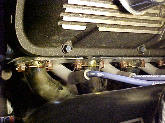

Safety wire is the way to go. Granted, it's not easy. Just get pre-drilled bolts and use small twisters. The bolts will never loosen. That's why safety wire is used in aircraft.
Here are the wired bolts on my Mustang headers:
Tom

That was my point, they're not easy. To make them look good you should buy wire twisting pliers.
Instead, these Split-Locks go in as a strandard bolt! When you're done, tighten the allen nut center!
Furthermore they are reusable..."did you say reusable? Gee I can't do that with the darn aircraft wire!" They also don't rust or corode...
Hey, if you like laying in the driveway twisting wire, have fun. I want to tighten the #$%^%&* bolts and drive. Any time and frustration saving device under $100 has got my name on it! I don't even like changing oil...I just wanna drive!
