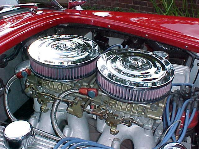

JoeA
These images might offer some ideas.
George
2x4 Linkage
2x4 Linkage
2x4 Linkage
2x4 Linkage
2x4 Linkage

Joea:
Following is another look. No slotted linkage on mine, but direct acting. The slot gives you progressive action.
"And at full throttle both carbs are fully open.", which is the way it should be.
Tom
