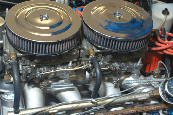

Well, I have been working though a acceleration hesitation and I think I am on to something. I have a 2X4 tunnel port set up on a 427 SO. Since getting it back from the builder, it has stumbled at low RPM response and steady driving speed (this little stutter). Well I increased the mixture to run richer to get more gas to the thing below 3000 RMP and that helped, but man...red lights were hell to sit through and just to rich. When I got it to do well moving, idle at a stop light was horrible. Then, I started thinking about the linkage. It is on a progressive linkage, new from the builder, so I thought I would go look at it. It seems like a LOT of travel before the second carb comes in. So until I romp on it, I was running on 2 barrels for a 580HP motor. So, I took the linkage and put a bolt in it to take out the slack of the progression and man did that car wake up. No hesitation. Runs much better. Now a couple of questions. I have to redo the idle mixture on the 2x4. On the idle mixture screws (4 of them on 2 Holleys), what is a good starting point when adjusting them. I have heard all the way in and then out 1.5 turns. Is that correct? Also, do they make different sized link arms to change the actuation of the progression? Is there a kit that I can get to fine tune the progression. I know there is some adjustment on the arm itself, but it is still out of range with it all the way set to the end. Thanks

Let's see a photo of each side of the setup you have so we're
all on the same page.

I know where there are some, I think. I year ago, a guy with a Classics came over to me and told me had some if I was interested. I may be able to see if he has any. BTW, you guilted me into taking pics (smiles). I did not get the numbers of of them, didn't take the time to pull it all out. One has the number filed off as well..I remember from looking once before when I had them off. Pics will be in my fold in a minute. I just put a small bole in the slot for the progressive linkage. I did have to file down the top of the arm to get it to duck under the fuel line, ( I know, I need to replace the like,,,,it has cracks...new hose is in the bag in the garage, but right now worried about my squeak and what I am finding in my oil filter right now)! AAARRRGGGHHH
So, check it out
Buzz

For comparison. Our linkage is very similar. Mine has the progressive slot, and the engine does not stumble.
All my ex's live in Texas

Did you steal my car, Steve? (smiles) That looks awful similar....

Is your front carb delivering a good squirt of fuel from the accelerator nozzles?
