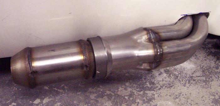

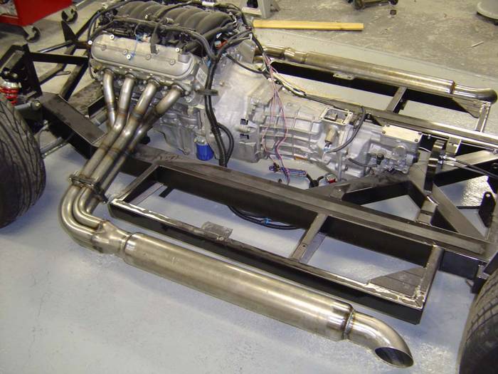

I've built a few sets of pipes with cats in them. I use a 4" cat inside the 4 1/2" body of the side pipe. They are removable and replacable and you can repack the baffles. I'm now looking at some other options for the muffler section of the baffle to try and control the heat a bit better.
There are a bunch of pics in my gallery:
