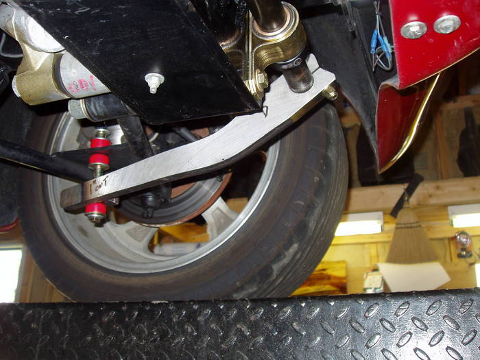

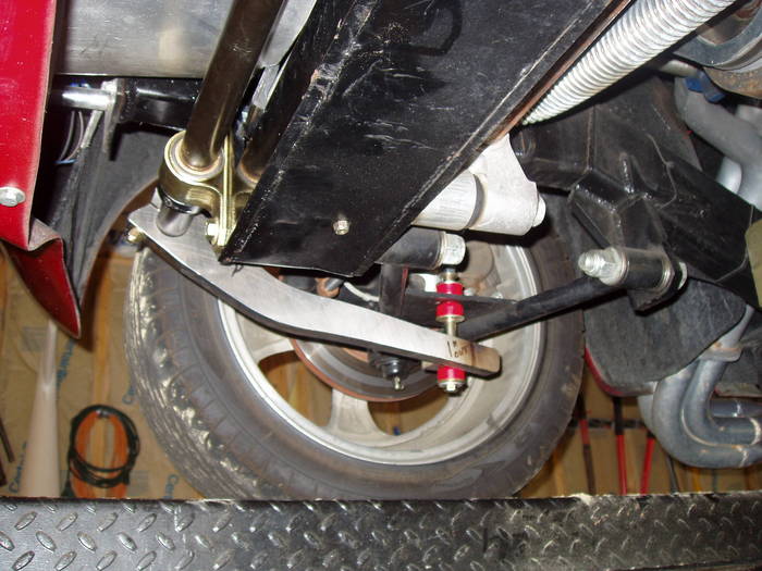

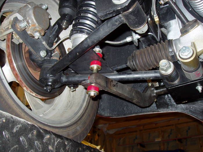

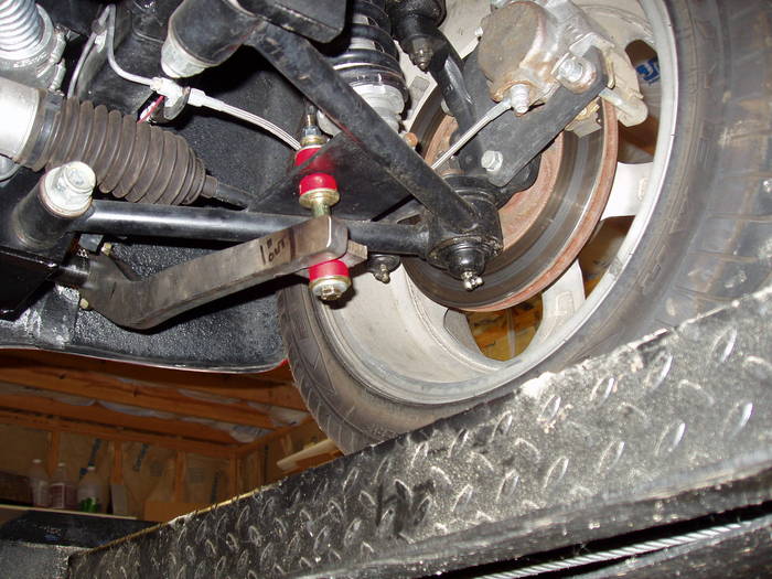

Sorry about the delay. Been getting one of my youngins off to college. I have started fitting bar and have started drilling mounting holes, I only had 5" of clearance between my body and the front frame to get drill into. Bought a Ingersoll Rand right angle pneumatic drill and with a 1/2 " Unibit I was 5 " from back of drill to end of bit. Really worked pretty well - use a little lube - drill a lot better. I bought standard sway bar links and will get fitted up soon. I will post pics once I get is all sorted. Unless I am missing something I cannot believe LSC does not support and sell some kind of kit like this rather than us having to figure it all out. It is fun though.
Bruce

Posts: 557
08-27-2006, 10:27 AM
Join Date: Oct 2004
Location: Roanoke,
Tx
Cobra Make, Engine: 2002 Lone Star Classics LS427, 428 CJ engine stroked to 464, 580hp/590tq at flywheel
Posts: 557
BTW - Once I have tested I will take arms and get powder coated.
