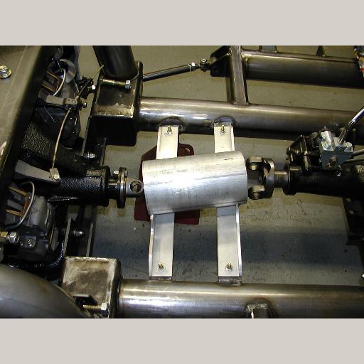

Check out this pic that I just noticed in the archive (circa 2003). This is arguably the best solution that all of us have been jawing about, though the construction and clearances for same would be slightly different for each manufacturer.
-Dean

Wow - I thought my driveshaft was tight getting in and out of the car. This one has to be a real treat to work on.

That looks like aluminum. Ya think it would hold that driveshaft? I dunno... On the other hand, the driveshaft wouldn't have much "running room" to start flopping. Fabbed from steel, yes; aluminum, . A good solution if you don't mind not being able to grab hold of the driveshaft and check the slop. Actually, it's similar in concept to the Buckshot tunnel.
