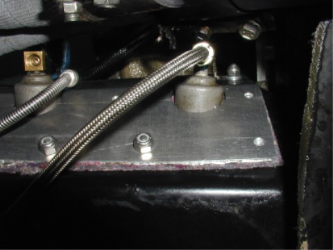

Actually, I am using the AFCO torpedo (girling) type mc's. They are small but do protrude through the firewall. I made an insulated plate to mount on the engine side of the firewall. No problems after 7 years.
This shot was taken while laying under the car shooting upward.
Roscoe
