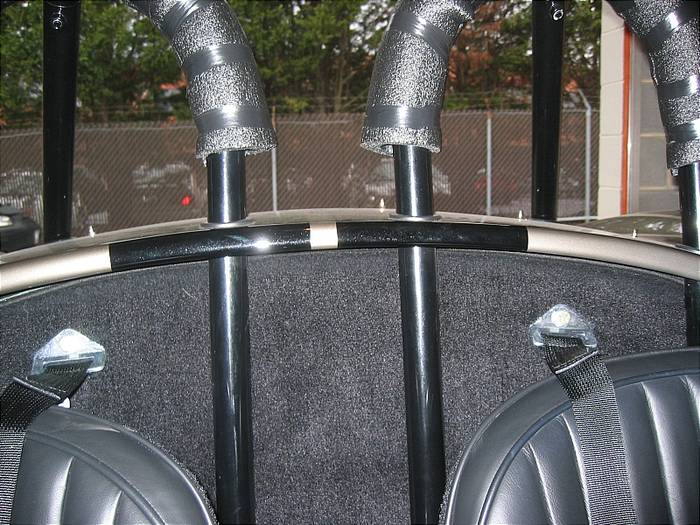

Does this help?

CSX3020:
CCX3682

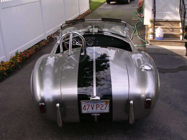

Posts: 7,592
SPF 1049
