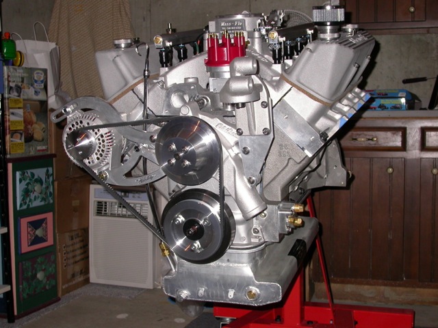

As my motor nears completion, I've been contemplating building a test stand. I need suggestions for a fuel tank. My motor is fuel injected and needs a return line. I definitely don't want to buy an expensive fuel cell just to make my little stand. Suggestions?
thanks.
phil
