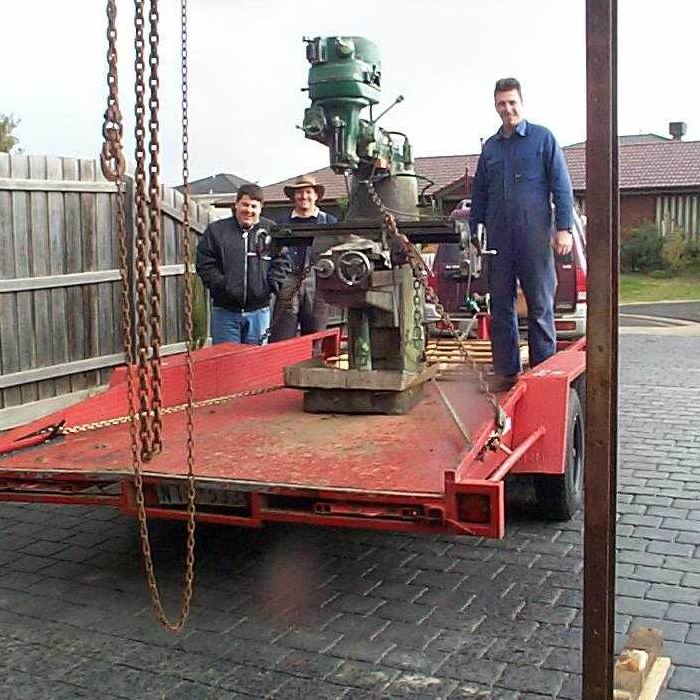

I enjoy using the mill so much that I've moved on to my 3rd milling machine now. I replaced the bench top unit with a big old turret mill that I restored.
This thing probably weighs 2 tons and stands 7' tall.
Restored and in the workshop
In the last month or so I sold the old turret mill and bought a brand new Taiwanese machine. This thing is awesome. I thought the old turret mill was great but this machine makes the old one look like a dinosaur.
It's got a much bigger table and more travel in every direction plus the 3 axis Digital readout makes machining dimessionally accurate parts easy.
You need a bit of floor space for one of these bigger turret machines but you can pick up some bargians with 2nd hand industrial stuff. I reccomend getting the biggest machine you can fit in there/afford. As an old machinist friend has often quoted to me "You can do a small job on a big machine but you can't do a big job on a small machine"

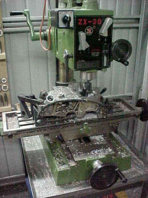

Here's a pic of the bench top mill I used to own.
I'm using it here to bore out the engine case for a bike I built to take larger sleeves for a big bore kit.

I don't reckon a 1/4" cutter will ever cut a 1/4" slot. The flutes of the end mill will tend to pull into the workpiece in one direection of traverse and ride up over in the other direction. Also the cutter will move in the slot just with the flex in the tool itself regardless of how rigid the mill is.
I use a cutter smaller than the slot and cut it in several passes and cutting the 2 sides of the slot seperately. For the most accurate slotting in a mill I reckon you need to use a slotting blade.
You can still get accurate results with the lighter machines, it just takes longer because you have to take smaller cuts and more of them.
