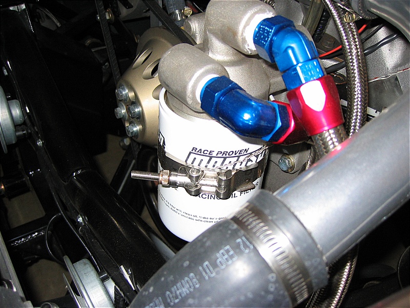

We went through all of this a few years ago and came to the conclusion that Moroso was probably the best... but who knows. Max, is this page true? http://www.moroso.com/catalog/catego...?catcode=20002

... and it looks even lovelier when you safety wire it.:cool:
http://www.clubcobra.com/photopost/d...orososf001.jpg

madmaxx 10-28-2010 11:42 AM
That would look a lot better with a filtermag on it instead of a clamp!!!!
RodKnock 10-28-2010 11:44 AM
With the blue spark plug wires, the blue and red line connections, now I can see why you want to use a basic white oil filter. You have WAY too much going on in there. A decorator's nightmare.
Have you safety wired your drain plug? Now we're talking. ;)
