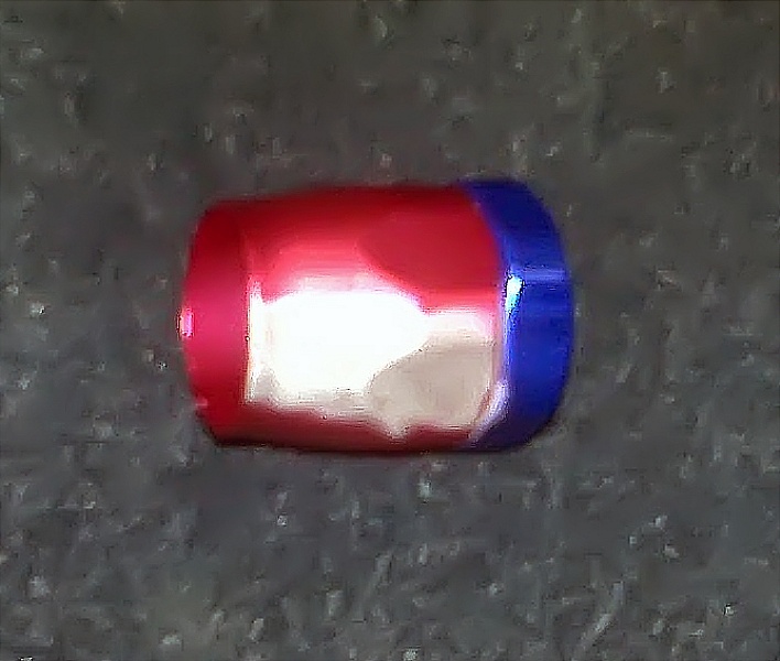

patrickt 10-29-2010 09:49 AM
Originally Posted by RodKnock (Post 1086369)
...the blue and red line connections... ;)
Once again, you nagged me in to taking action. I had an extra Blue/Red fitting sitting around -- did you know that the color polishes right out? Lousy pic from my BB:
http://www.clubcobra.com/photopost/d...redblue001.jpg
RodKnock 10-29-2010 09:57 AM
The great Buddha said " I never see what has been done; I only see what remains to be done."
You gotta a lot work to do my friend. :)
