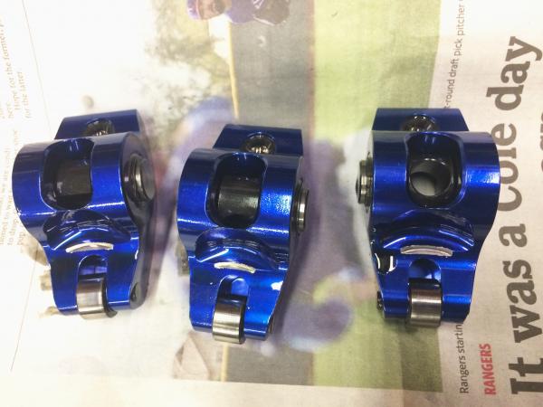

#5 exhaust valve rocker underside
Old 06-05-2017, 02:32 PM
Join Date: Nov 2014
Location: Lipan, TX
Cobra Make, Engine: Superformance MK III Roadster, Roush 402
Posts: 57
other left bank rocker undersides

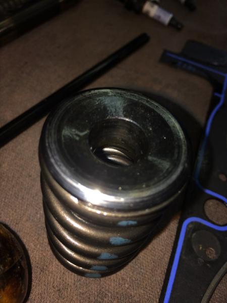

#5 exhaust exhaust valve retainer & springs - note wear all around the high point of the retainer, matching the wear on the underside of the rocker.

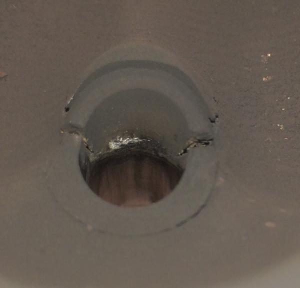

#5 exhaust valve guide, side view, showing cracks.
Old 06-05-2017, 02:45 PM
Join Date: Nov 2014
Location: Lipan, TX
Posts: 57
#5 exhaust valve guide, top view, showing cracks
