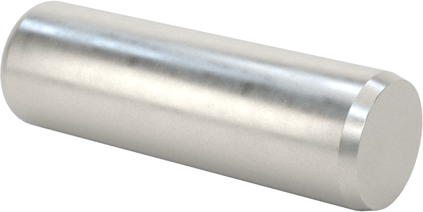

There are differing types of roll pins with differing strengths. This is a pic of a simple slotted tubular roll pin;
It is on the low end of the strength scale and the easiest of all the choices to fail. This pin in a 5/32 diameter (0.156") has a breaking strength of just over 2000 lbs. Its durability can be somewhat improved by using spring steel. The underlying problem is insufficient metal to provide strength. It should not be used in moderate to high torque applications.
The next step up the ladder is the rolled roll pin, no pun intended. This pin is essentially a spiral version of the slotted design. It looks like this;
The rolled steel roll pin in the same 5/32" diameter has a breaking strength of 2200 lbs. Not a shrinking violet but there is better available. If you get the hardened steel versions, this pin will have a breaking strength of 2700 lbs. It's better, but there is still one more alternative. This is what it looks like:
A solid steel dowel pin, in a 5/32 diameter, has a breaking strength of 4100 lbs. It is highly improbable that you could damage that pin when using it to anchor the drive gear on the distributor. Of course, you could go up 1/32" to a 3/16" diameter pin. The breaking strength jumps by almost 50% to 5,900 lbs. This one fits into the virtually unbreakable category for your type of service.
The chances are 50/50 that Ford used a solid steel pin. It is more likely they used a rolled roll pin. Easy peasy, lemon squeezey, as the saying goes. Simply push out the old, push in the new, and don't worry, be happy.

It doesn't matter who supplied the distributor. The issue is not the supplier, it is the parts used in the manufacture of the finished product. Roll pins are cheap and easy to install, and that is what makes them attractive.
Your issue as the owner of the equipment now becomes, what do you intend to do, if anything at all?

As far as pinning the distributor to the gear there at least four levels available:
1) the stock pin which can fail (the failure is almost certainly pure shear)
2) double pinning can be used; two pins are used one above the other (but not too close) and at 90 degrees from each other. Those who've tried it claim it works fine.
3) a hardened roll pin in the standard OD
4) a larger OD hardened roll pin; the diameter increase can be small so as not to weaken the shaft; a small increase in diameter will give a significant increase in shear strength. I have read about one setup where a 5/32" roll pin is used with a 3/32" one nested inside the larger one. The "splits" were 180 degrees apart. It replaced a 1/8" roll pin.
What flavor should be used? Slightly subjective maybe ;-)
