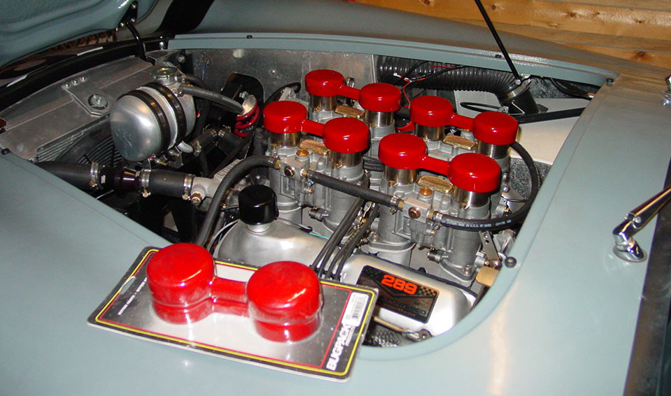

Redline Weber. Tom was great to deal with & it looks as if the baseline set up was pretty damn close, we'll see when I get things dialed in a little better. He was actually one of two who had the manifold in stock, seems there's a problem with one of the foundries right now. I had to modify the fuel blocks to get the rubber hose look I wanted(about 5 trips for parts  ) , drill & tap the Y manifold for the temp sending unit. Redline had a reasonable price, would recomend!

Oh yeah! Almost forgot, Installed the Oil cooler lines too!!! Fram PH16FP wasn't in stock but STP filter number S16 is a shorty filter that fits inside the frame

That is beautiful. What are you going to run for air filters?

Filters?  I have been told that they really mess with air flow & that I shouldn't really need them. A couple guys run them around here this way but to be honest it does make me a bit nervous...

I'm curious because I have a 48 IDA setup which will go on my motor. I was told by Inglese that the K&N booties can actually improve torque outout. These are not the snap-on plastic type, but a soft slip-on filter.
The look of the open weber stacks is sheer beauty but the idea of running without filters makes me nervous too.
Jack

I have the Imagine setup for EFI and have the same dilemma. On the dyno there is about 24RWHP difference with the stacks on vs the filters. So of course I would love to run the stacks all the time, and they just look right!
Finding a good (read - good looking) solution seems to be a common problem. I am sure some entrepreneurial craftsman out there can come up with something?
If anyone has suggestions, I would love to hear them, as the sound of a few small stones heading south into those stacks is a big concern.

Brett mentioned on another thread that someone had used domed tea strainers & affixed them with grommets. so I ordered some of these from cooks nook in 3" diameter. I will attempt to fit them when they show up. I'm curious!
