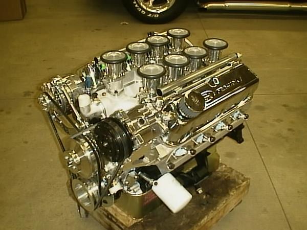

Yo 427,
I second, third etc. the opinion that a new block is the way to go. I went with the Dart Aluminum for my GT40.
Here's a pic......Oh yeah Webers too.
And a stroked 351 to 418 with downstacks, fuel injection etc. for the Daytona...
The Daytona engine was and is scary fast 560 HP 580 ft. lb. torque, the GT is a work in progress but, I have high hopes.
TR

That's a beautiful engine. I going to play it safe and go with the Ford 408. An Eagle 408 kit can be bought for around $900.00. That to me is affordable HP.

Good choice !!! It will be plenty of power and very dependable!! Although... I really liked the looks of that Dart Alum with webers....mmmmm How about a little less jewelery and a few more car parts.... Just kiddin. Let us know how it works out.
