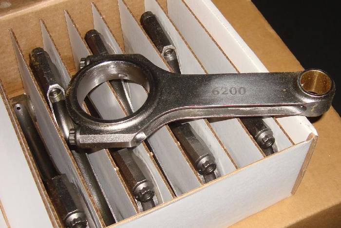

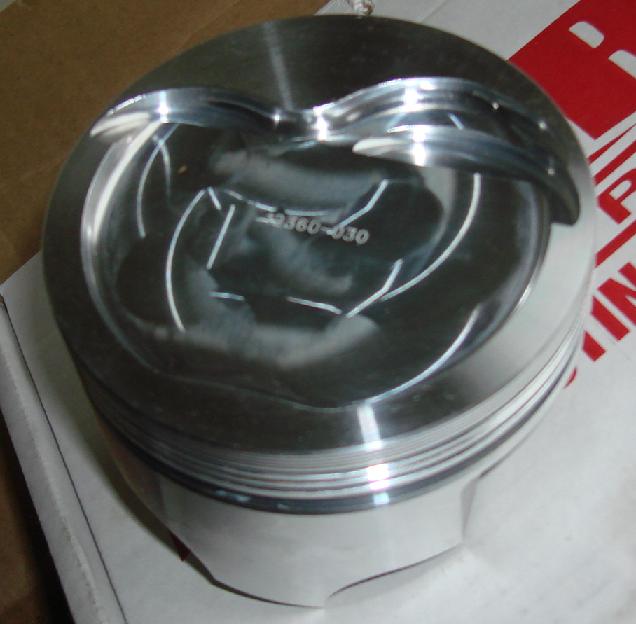

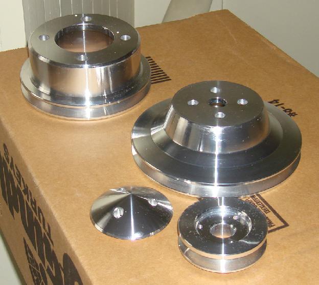

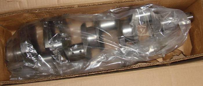

Well, due to the circumstances, my wife, daughter, and I celebrated christmas a month early this year. Here is the main thing my wife got me. Of course I picked it out but... haha
CHP 408 stroker kit & march pulleys
-cast eagle crank 4.00 stroke
-forged probe H-beams w/ARP bolts
-forged 22cc pistons
-ARP hardened oil pump shaft
-ARP oil pump bolts
-Melling HV pump
-clevite 77 cam, rod, main bearings
-perfect circle rings
-march V-belt aluminum pulleys

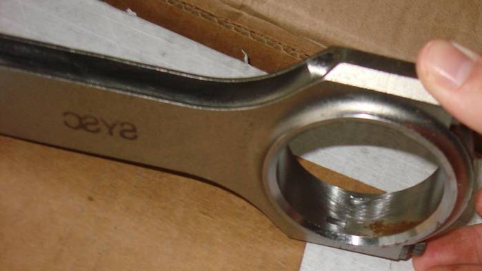

Is this something I should be alarmed about? The main side of this rod has a small amount of surface rust on it.

thats not rust---its rod oxide
Jerry
PS--220 wet/dry sand it off

Thanks Jerry! Good to know! I was worried when I seen that!
