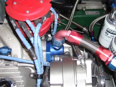

I'm not sure about your distributor but I'm using an MSD 8598 billet distributor on my engine (a Ford racing 345 horse 302). The 8598 distributor comes with a large, Ford-style cap that interfered with my air cleaner, so I purchased and installed a smaller, Chevy-style cap and rotor. The part numbers are 8433 for the cap and 8467 for the rotor. My cap is red but I believe that MSD sells a small diameter black cap, too.
