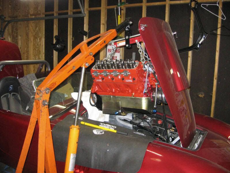

I prefer to remove those assemblies individually. Especially the TKO's, because they're bigger and heavier than the T5's. Smaller lighter packages are esy to manage, and less risk of body damage if you make a mistake.
I also would not remove it through the interior. Mostly because of the risk of damaging the interior. I'd hate to leave a trail of oil behind.
Although mine is an FFR, the dimensions are about the same. I don't even remove the hood to get the engine out.
http://i13.photobucket.com/albums/a2...l_001small.jpg

bobcowan 01-07-2010 10:47 AM
Originally Posted by Pman1961 (Post 1016042)
Thank you for your responses. I really do not like the idea of removing the tunnel fearing the interior will never look the same. Is there enough room to unbolt the transmission from the motor and support it from underneath, remove the motor independently, remove tranny. Next after motor work is complete and before in stalling in car would be to install clutch, bellhousing, test fit tranny for alignment, remove tranny from motor, put tranny in its place from under the car and support, install motor independently, bolt tranny to motor, etc. Does this seem like something that will work. I would prefer to pull the motor independently so I could leave the hood on and not worry as much about banging the car. Thanks again!
That's the way I would do it. Smaller packages are easier to handle, less risk of an accident. I'v R&R'ed my engine 6-8 times over the years. Always do it just like the above picture.
Getting the trans out shouldn't be that big of a deal, either. The easiest would be a rolling trans jack. But you can also use a motorcycle/ATV jack. Either raise the fram enogh to roll it under, or use the crane to lift it out.

I would use blankets on every fender and have no paint visible, one scratch or gouge and you loose. The picture above with just the fend protector, wow, that is a gamble when it comes to scratches.
Hydraulic hose could break, seal fail, somebody kicks the hoist, at least with some padding you will avoid the accidental scratches.
with the right balancing bar you can install the engine and trans together without any issues. no brainer remove the hood.
