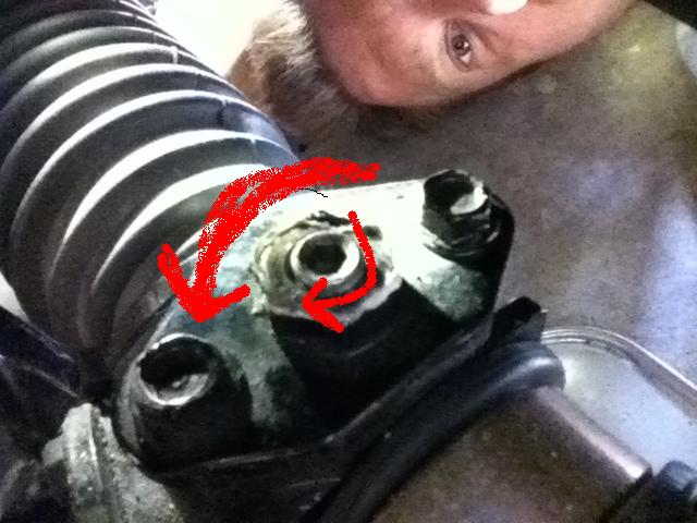

Originally Posted by Blas View Post
Your are good to go. They have replaced the hex head stud with a slotted head stud, probably a better way to go as it would be difficlut to over-tighten it with a screwdriver vs using a wrench...Keep us posted.
Blas - attached a pic of 2632. Looks like I have the hex center bolt as you had described. Do the arrows describe what Olthoff's have outlined? Loosen the larger nut and adjust the center with an allen key or socket?
