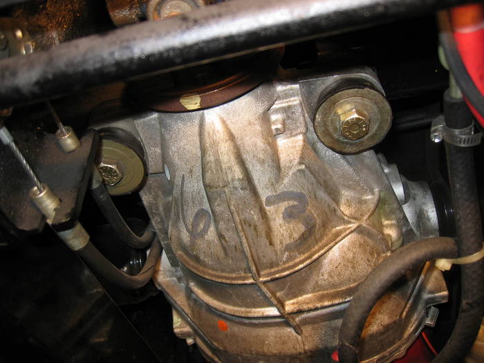

The next thing would be to solidify the rear differential. This involves taking the rubber bushings out of the front rear diff mount and making this connection solid. Locate/fabricate some solid aluminum "bushings" and replace the rubber. Dennis says this will transmit a little noise, but helps a lot.
Here's the bolts I mentioned:

Is this a jag rear?
Old 10-10-2007, 10:53 AM
Location: Bloomfield Hills, (Detroit area), Mi
Cobra Make, Engine: Superformance 156, ex Paxton 351, now a 392 Ford Racing Stroker
Posts: 1,666
That serial SPF would have a Ford '94-'97 Thunderbird rear end , NOT Jag . Bill
