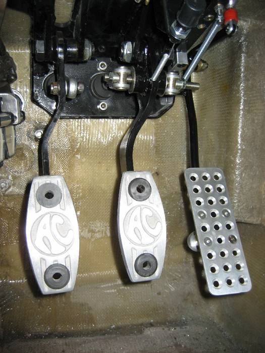

Heel Toeing is something I struggle with. I decided when I built my pedal setup that I would make the gas pedal completely adjustable so I could hopefully get it right.
The pedal tread is adjustable up down laft and right via the counter sunk cap screws holding it in place.
The pedal is on a threaded boss so you can change the pedal height without changing the travel or throw. You can also set the face of the pedal on an angle. I've also incorporated an adjustable back stop so the pedal bottoms out on the bulkhead rather than stretch the cable.
I've been on the track twice with it now and I'm starting to get the hang of it. The first time out I played round with the adjustment and now it's pretty good.
Mike Murphy

Aussie Mike has the most elegant solution I've seen. I struggled with SPO 1862 and finally settled on a position of heel and toe that, while awkward, enabled me to coordinate my movements with the mechanics of the car during severe braking. After replacing the Superformance with a Nissan 350Z I appreciated the contribution correct pedal position makes to what is now a straightforward, largely natural movement.
The difficulty does not come solely from your ability to coordinate the necessary movements. Pedal arragement is crucial and the design Superformance uses to replicate the arrangement of the original cars could be improved. Mike's solution demonstrates that the needed changes in the relative positions of the brake and accelerator pedals would occur in two dimensions. I doubt what would work best for you could be incorporated in a factory solution. More likely the needed arrangement would have to come from trial and error, taking advantage of the flexibility demonstrated by Mike's design, or something like it.
I have had success with adding plates to the left side of the accelerator pedal. Others have bent the bar that supports the pedal, moving it closer to the brake pedal. Neither of these techniques helps with the difference in height that results when the brake pedal is depressed and you want to briefly depress the accelerator.

I did mine from the point of view that I didn't know what would work since my performance driving experience was limited. This car is a platform for me to learn on.
I figured it was easier to make a pedal that was easy to adjust at the track without having to resort to bending things or welding a different pedal tread etc.

I have full adjustment of pedal hieght with my throttle linkage Rods and my pedal stop if you look close is a nut welded on the rod just above the pedal.A bolt and lock nut for stop adjustment.
Assie Mike's is way nicer than mine but it works well.

But Mike's are on the wrong side of the car!!!!

Their still in the right order. That's all that matters.

Check the picture again. They are not on the wrong side they are on the "Right" side
