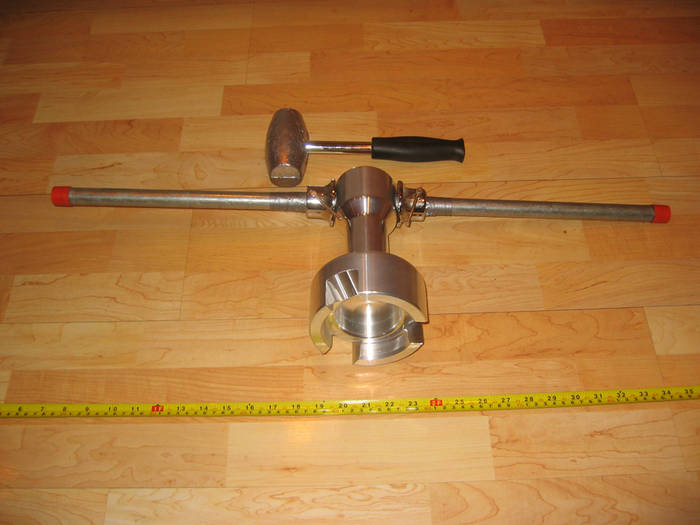

If you can't loosen one up with a couple whacks of the lead hammer, fashion yourself one of these and you can lay down some pretty serious torque on those spinners.

Having seen photos of those spinner wrenches before, I have wondered how you keep the thing on the knock-off itself? Seems to me it would want to simply slide off as you applied pressure.

That steel pipe that I have shown there is about 30" long -- it's a nice length that fits well in both your hands, of course by having one hand on each end. By pushing down with one hand and pulling up with the other the applied torque is very even in the middle of the wrench and you're actually pushing it in to the wheel; there is no slippage. That's different than having a normal wrench, or ratchet, where the socket is at the end of your wrench. I think if you tried to do it that way it might slip off.
When looking at one of these, I have always thought they should have added notchs so that the spinner was locked into the tool. As it is it could slip off and you could damage a wheel when you went a$$ over tea kettle across the garage.
