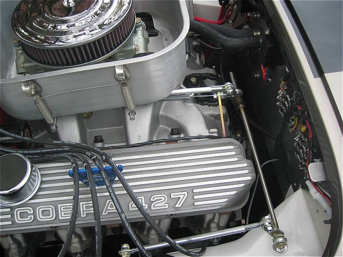

You can get the exhaust bolt from below with a bent wrench. Make the footbox hole for the #8 spark plug. Make small cover from .005 aluminum or tin with tap screws to close that hole or heat will kill you.
ERA Chas - Does your footbox and #8 clearance look like this? I'm wondering if some of the changes ERA made starting with car #731 included trying to fix that problem.

Yes the footbox has that general shape. The early cars (which is what I have) do not have the extended boxes which came later but I do not know at what chassis number.
The difference with my car is the reservoir which is mounted on top and the clutch line which crosses the footbox and goes down the side to the clutch master right at the last exhaust port. My clutch hard line is covered in Firesleeve for that reason.
You later number guys have the 3 cans on the fender well. Don't know if 392 which Argess has came with the cans or my set up. I made that access hole 21 years ago.

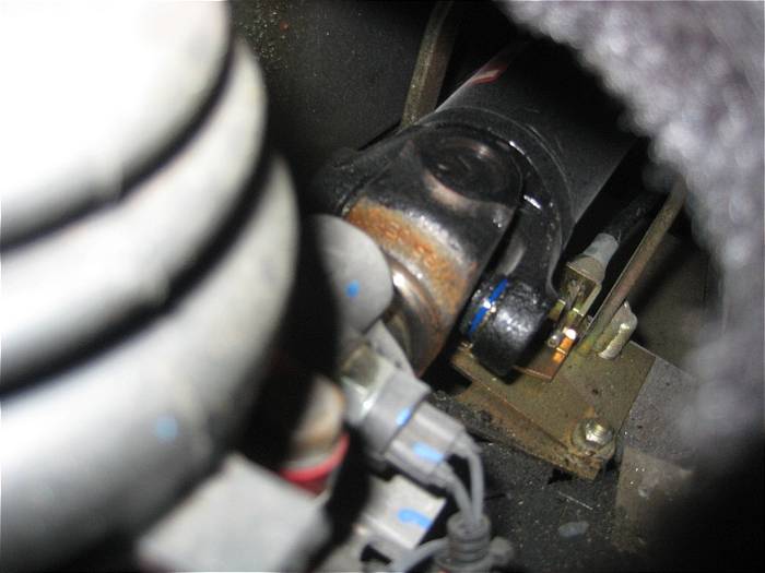

Default My Problem is Obvious...
No.
It's a poor photo but the joint is well clear of the crossmember from below.
This is a shot taken from the trim ring hole with the shifter removed. It shows what I'm up against coming from beneath. I think with a long grease gun adaptor and one of those swivel gizmos at the end I can grease the u-joint through the trim ring hole, otherwise I'll pull the passenger seat out and install a trap door on the tunnel. Chas -- you did install a drive shaft safety hoop after snapping that picture, right?
Yes, thanks for asking. This was reassembly after a clutch change in April.
