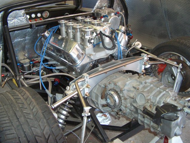

Well it took me long enough but I finally got the engine to fit (mostly). Nothing seemed to fit the first time or the second time or the third ...
I would like to give a big thanks to Thomas for helping out this past weekend.
Next is the clutch (still waiting on parts) and the plumbing.
John

Here are the specs and another pic
351W production block stroked to 408
Eagle 4.00 crank
Scat h-beam 6.200 rods
SRP dish pistons
comp cams hyd roller 236-242, .555-.576, 110 ls.
Brodix track 1 heads cnc full port.
TWM Stack injection
FAST XFI control box
Max HP 527 @ 5800
Max TQ 546 @ 4500
John

Still making some progress. I got the trans and a few other misc stuff in.
Here's an updated pic.
John
