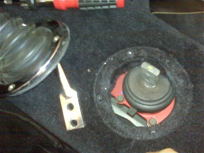

07-10-2009, 11:00 AM
Posts: 22,025
Originally Posted by RodKnock
Can the switch be made from the interior of the car? I should have thought of this before.
Yes, but you're going to have to pull the tunnel. Having just had the boot ring off I just don't think there's enough room for an arthroscopic job. Here's their instructions page. It appears to be a pretty straight forward task. http://www.steeda.com/directions/
07-10-2009, 11:15 AM
Posts: 22,025
See what I mean?

07-10-2009, 06:36 PM
Posts: 9,592
Originally Posted by patrickt
See what I mean?
I'll have to pull mine off, but I think mine has a little more room. How much more is the big question.
