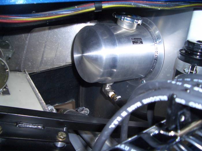

I just installed a moroso overflow tank this week. I bought mine at Summit Racing: http://store.summitracing.com/partde...5&autoview=sku
I just documented the install of the overflow tank on my blog. See my signature for the URL
