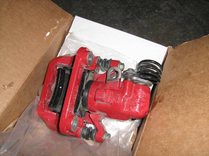

2 modif have to be made for the rear caliper to fit the lockar cabel.
1- drill the hole to make cabel fit inside
2- shave the braket
