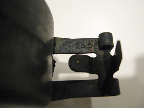

While the carbs. are off I started adjusting the floats. Made my own gauges and got the first one done at 5.5/24. Then noticed a number on the float, 25.5. To me that could mean two things. One, replace the 24 with 25.5. Two, replace the 24 with 25 and replace the 5.5 with 5. I measured the next carb. And it is 5.5/25. What do you guys think?

25.5 refers to the float weight.
25.5 grams.

Thanks carmine,
The one float was off 1 1/2 mm. I'll adjust the other 3.
