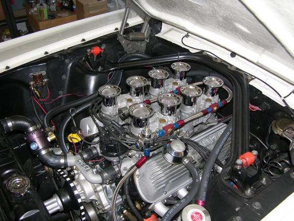

I'm just getting started to get acquainted with them, so far so good. I am curious as to how much initial advance you guys are happy with? Except for the Webers it's a stock 289 HiPo K code engine

got the best vacuum signal at 18 degrees BTDC, so that's my starting point, using the 21 degree bushing, giving a total of 39. Stock is 40 degrees , so I'm not too far off as far as that goes.
thanks for information.
by the way, I'm hearing that the screens I'm using are too restrictive ? Any one done a with and without comparison?
Z.
Z.
Do your screens have a foam filter media, or just the screen?
If it's just the screen you should be fine.

just a mesh screen, no filler, foam, or fabric. You can see right thru them. Anything (hopefully air) smaller than a 2 year old child should pass right thru.

Z. Ray, Jim Inglese sells what he calls debris screens that are really good and not restrictive as the ones you show. I have my GT350 and run 48 IDA Webers as well. As for your original question re advance. 38 degrees total all in by 2500 rpm, I had my OEM Hipo distributor re-curved with 29 degrees in it by 2500' 9 at the dampener.

by the way, I got the Weber's & manifold from Jim I. as well. He is claiming no difference in performance with the screens I'm using. I do have some performance issues to be resolved, but they are not related to the Webers. I'll be doing a dyno session sometime soon to provide a definitive baseline for future comparisons and changes. I'll be sure to do a run with and without the screens..
