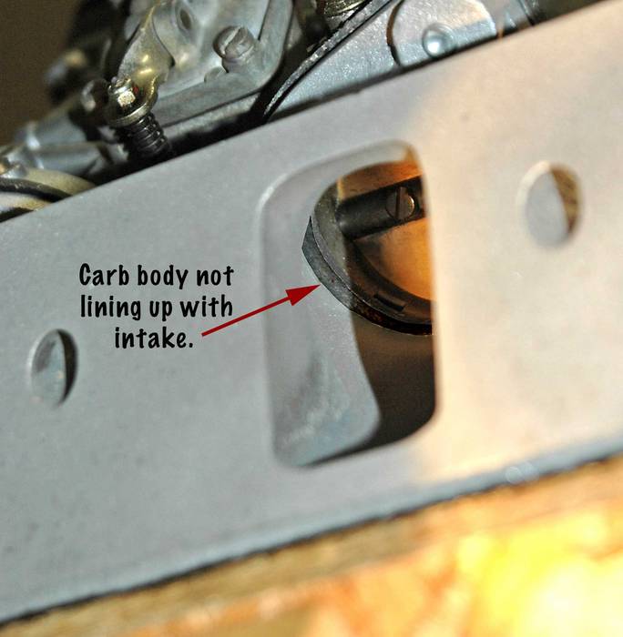

I have a 302 Weber 44 IDF setup. I was looking up into the manifold port and saw the carb body is not lining up with the manifold. Is this a big deal?

This is more common than you would think. I have the same thing on the manifold I am working with, and will be correcting it as needed. You can either build up the area with a good epoxy (rough up the area to be bonded first) or add weld material and the grind and port match the manifold to the throttle bores. Epoxy is used commomly by those that change the interior shape of 4 bbl manifolds. You will most likely find similar mismatching at the mating surface of the head.

Is this going to cause a flow problem? What kind of epoxy are you using? What will you use to machine the built up areas, a grinder?

JB weld would work OK, that is what I will probably use. There are other epoxies that would work too but at this moment I am not sure of the Brand names. As far as machining or grinding it afterwards, I use a High speed 20,000+ RPM Makita grinder that will hold tools with 1/4" diameter shafts. Get a good round 1/2"- 5/8" carbide cutter and an tapered arbor that will accept tapered abrasive rolls and you will have all you need.

If you use some type of 10mm thick phenolic spacer (which you should in order to keep the heat from creeping up to the carbs and boil the gasoline there) you can flare the inside of the spacers to match to the two openings.
That mismatch should not be a problem though.
The mismatch the other way round would certainly have to be corrected.
The intake manifold is probably made to accept 48IDA/IDF.
You should check the manifold to head mismatch. More important to match up there because of the rectangular shape.

Don't you worry about a hunk of that stuff coming loose and sticking a valve open or something?

All intakes for Webers were made for the biggest Webers available.
Downdraft there is only the 48mm max. Even those do not match. Intake is always bigger, fortunately.
I would not worry about that mismatch.

With the spacers you prevent the carbs from absorbing the heat from the manifold. The carbs heat up the gasoline in the bowl which starts to boil and dumps raw gasoline into the throats. No good for starting nor for the rings.
I even made myself some washers from the same material to be put under the screw heads. The heat transfer is minimal. No more gasoline dripping onto the manifold and no more gasoline smell. It works !
I got the 10 mm thick spacers from Inglese.
I had to reduce their heights to 6mm though because I was having some clearance problems with the hood.
