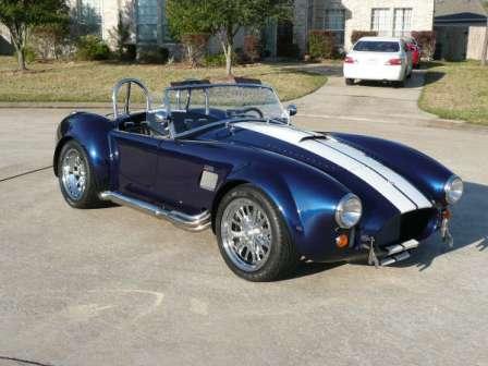

Default 48 Ida
Here are a couple of pics of my build in progress. I bought at Keith Craft 408w. The motor made 511 hp and 550 torque. Should be ready for test and tune in the next 7-10 days. I can post how the Webers are jetted if needed.
