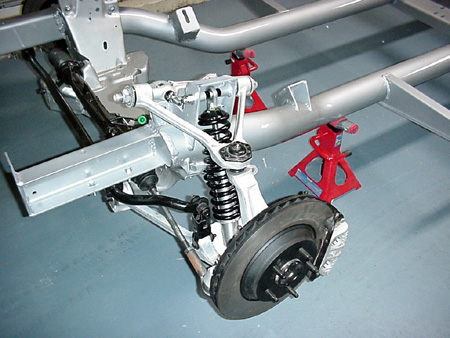

Mark,
It looks like you went with coil-overs in front, did you modify the upper shock mount?

Hey GS, thanks for the suggestion... I think that may be the way to go - I'll have my hands full here.
Scott - actually Brett @ E-M did all the modifications before he sent the frame. The front coil-overs are custom 600lb springs by Pro-Shock. Here is a better shot:

Mark,
When I ordered my car I tried to get Brett to do a coil-over suspension but they didn't want to get into it at the time (1999).
In 2000 I ordered a second chassis and gave Brett drawings of changes I needed in the design to use coil-overs. I had him make the shock tower taller to use a 13.3" Proshock. For the lower mount I used a billet aluminum, bolt-on mount. What length shock did he use on yours? Did you uses the aluminum lower mount? How about in the rear, coil-overs too?
Your car looks good.

Scott
That motor looks pretty good and at least it is not a Chevy. Nothing wrong with Chevies except they are used so much in street rods and kit cars that they are boring. Now a Hemi you do not see everyday.
I like the way you did your front coilover conversion of the corvette suspension. I have a Hunter Cobra and Randy does his really similar
