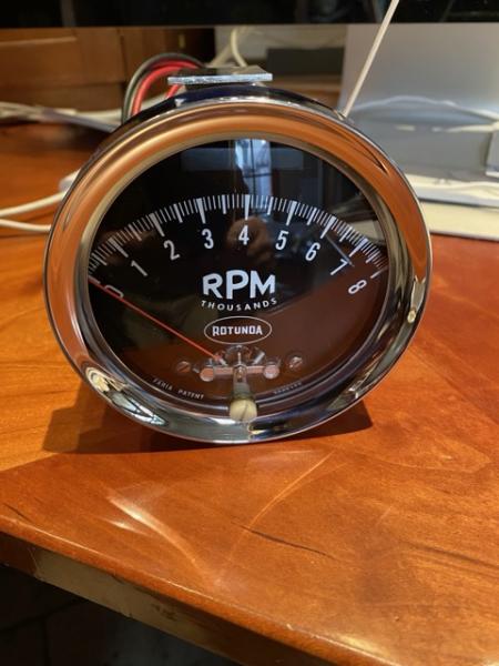

Also installing an original dated 1963 Rotunda tachometer, correct for this car. I am fabricating an adapter plate as per Dan Case as the Rotunda is slightly smaller than the Smiths tach - as per original.
