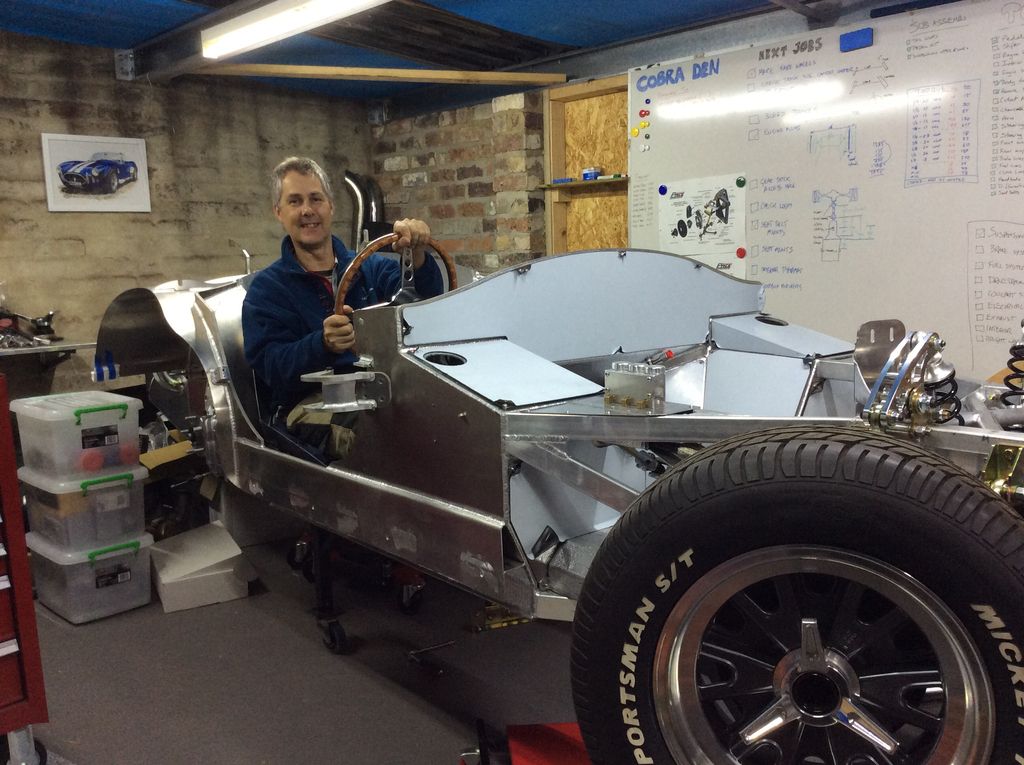

Mandatory vroom pic. I was checking the seat and pedal position

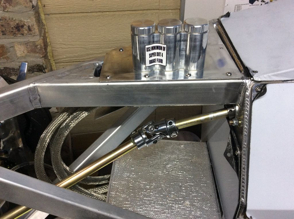

Custom fluid reservoirs.

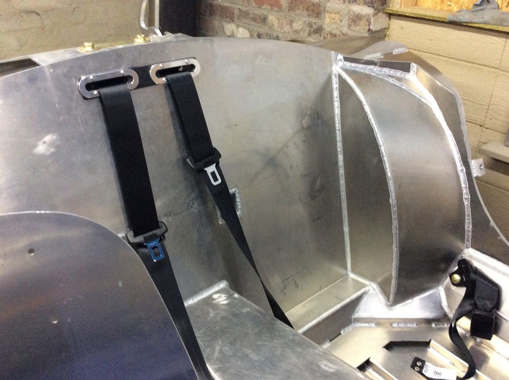

Seat belts done.

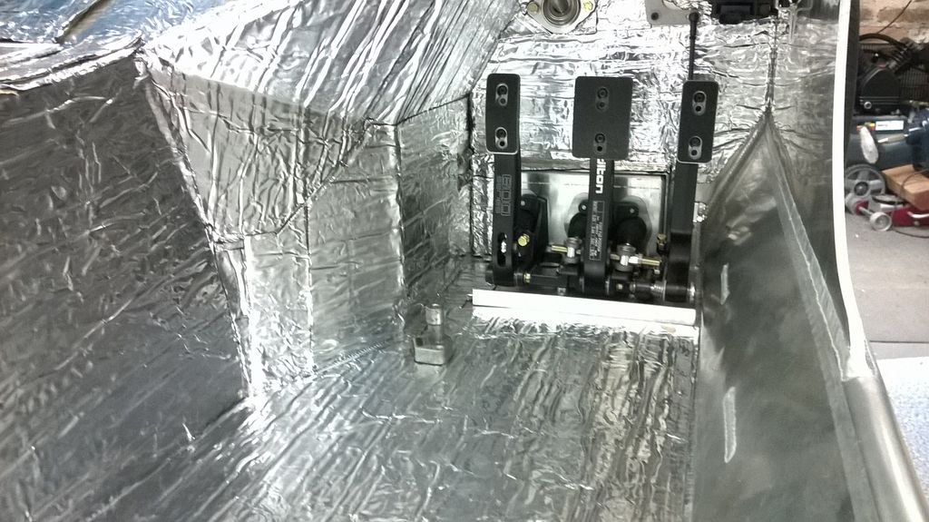

Sound proof lining, and heel rest mod (thanks Muz).

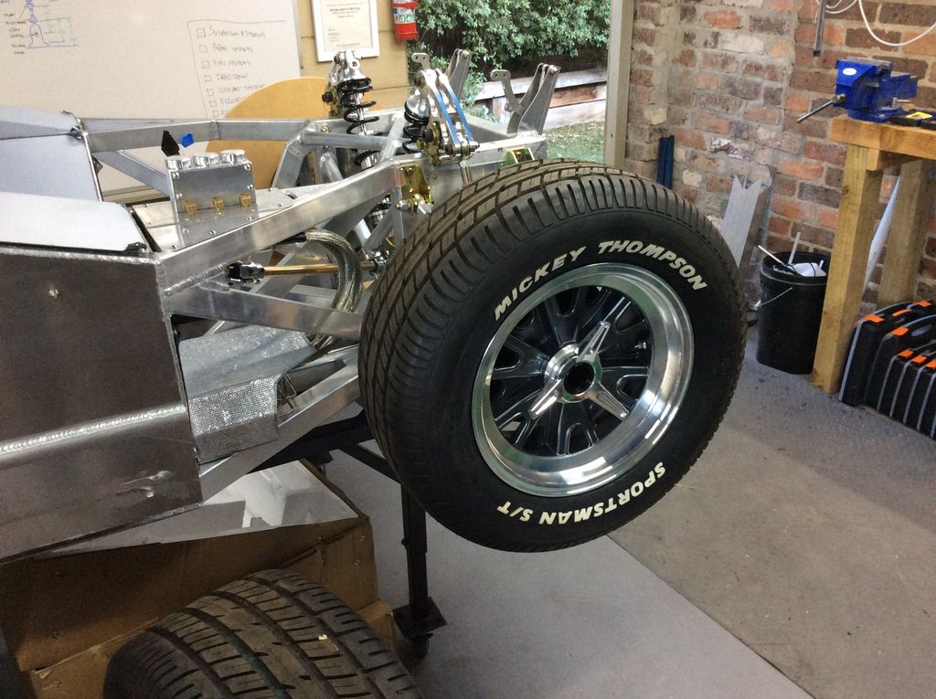

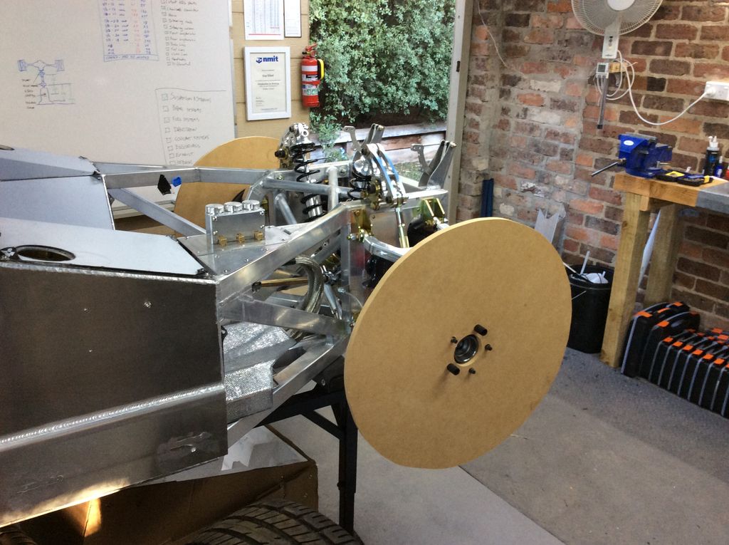

Also RobH recommended this idea of Flintstone wheels (well to quite - they're not stone!) to aid with rough wheel alignment, etc. dunno, but I think the steel and rubber jobs look better
