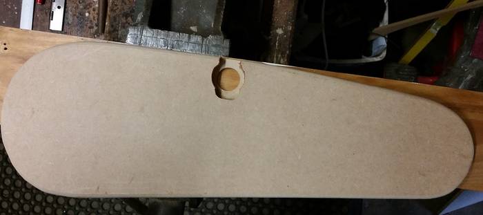

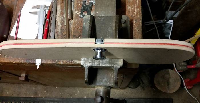

Glovebox door. Not sure of the exact method of construction on the originals, but my end result should be close.
A bit of free-hand routing to fit the retaining nut and the slide/catch...
Catch and lock trial fit...
Glen

Forgot to include the thickness of the leather (just over 1mm) so had to machine slightly deeper for the glovebox door catch/lock and retaining nut so that the catch plunger would clear the nut. My headlight torch is dead, so had to rig up a temporary light. All good fun!
