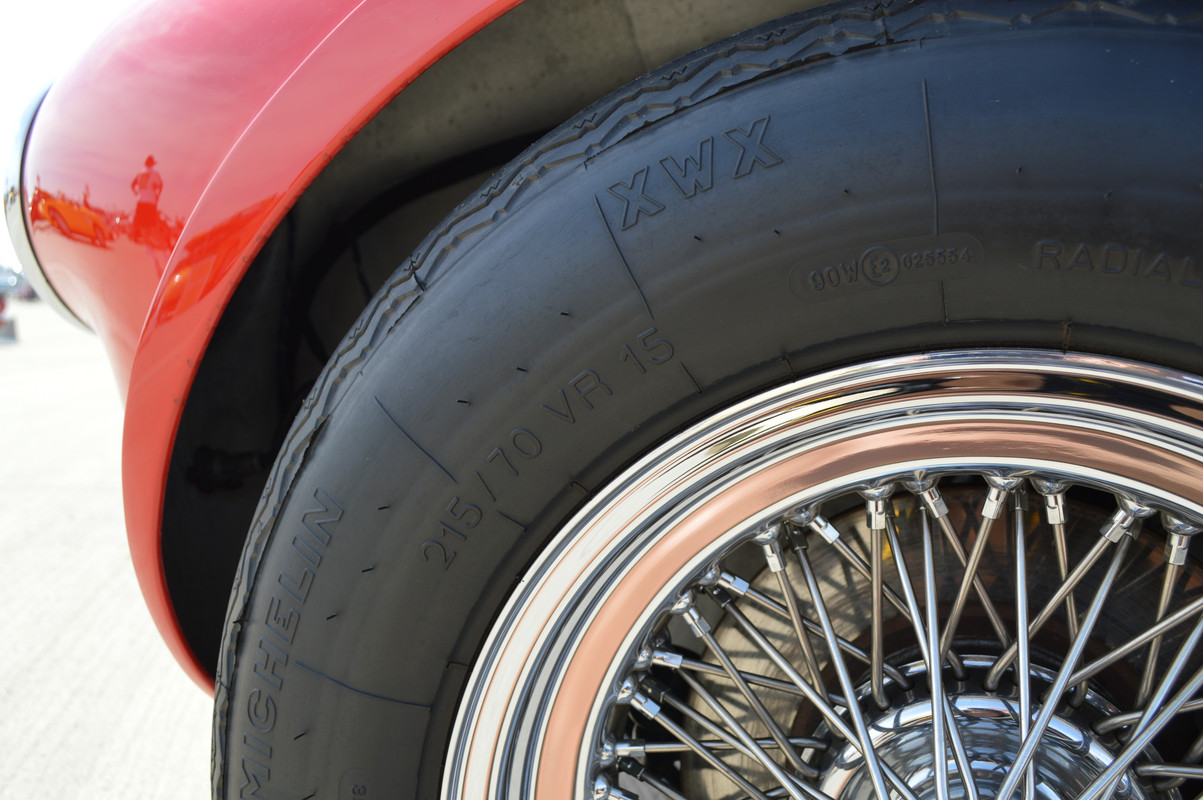

It’s totally personal preference but we’ve found the Michelin XWX 215/70-15 to be about the best looking tire and best performer on the market! Its not a white wall but it’s profile and tread pattern look “right” and I think you’d find it’s what most original owners use on their cars.
I had those on my 1985 BMW 535.
Didn't know they are still making them.
Old 06-20-2019, 06:35 PM

Larry,
Just like the tires on my Slabside.
John
