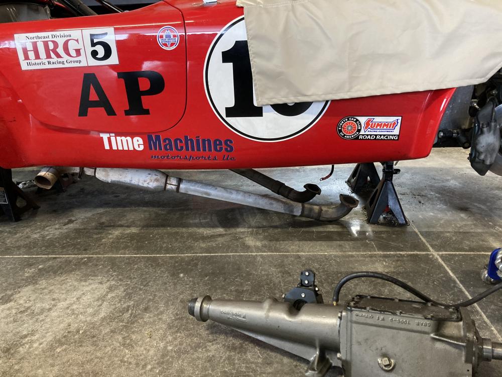

Larry,
Here are the pictures I took this morning. I included one of the side pipes handing down from the body so that you could see how they are connected to the header.
Cobra Restorers shows a set. Not sure if they are still in business or not.
https://www.parts123.com/parts123/yb...Z5Z5Z50000027b
Jim

Dan,
Those look quite similar to mine, with the exception that at the end of the collector I have a flange and the originals have a welded tube that carries further down and then bends out and back. It also looks like there may be extensions for the header bolts, which is nice as there are a couple of tubes that the header bolt heads scrape a little as you are turning them until you get them further seated.
Thanks.
