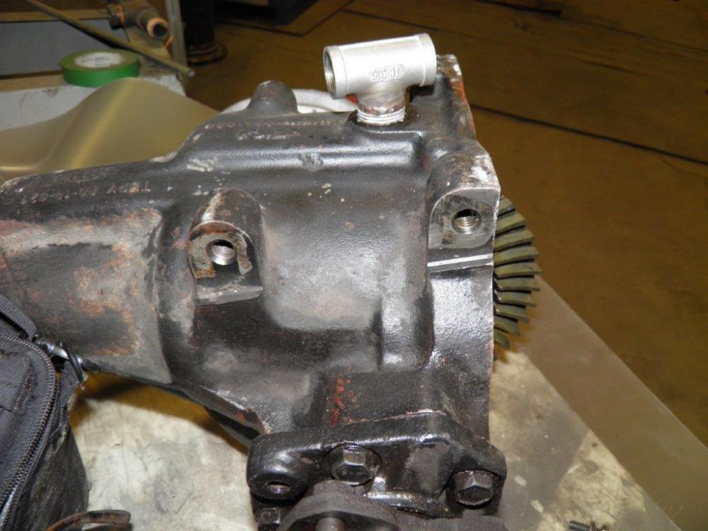

I think you might be better off just replacing the rear cover with a steel cover if you are going to put the vent and return fitting on the top of the rear end.....just saying...

Morris,
I will take that under consideration and run it by my crew. Quickly learning a lot about the internal working of differentials.

Morris,
Looks like we will be going with the steel cover. Thanks.

Rear cover!
Well, Ross did an excellent job on the rear cover. We were going to go with the steel cover, and Ross had one in hand, but he suggested that we should try to use the alloy one as it would help with keeping the temperature down with the differential oil, due to the cooling fins and composition of the cover. I concurred with Ross, as we will not be running an oil cooler on the differential at this time.
Ross was able to make the adjustments and welded in deflectors and tapped the holes on the rear cover for plugs. He also added a tee at the top of the differential in case we added an oil cooler at a later date. For now the tee will be plugged. Still have to do some final filing and fitting, but it is a definite improvement over the stock one.
Thank you everyone for your input. I am anticipating receiving some final photos of the car before it is loaded n the shipping container shortly.

Full credit to Morris for this mod as I have never experienced this issue before. I did not want to drill and tap the case up front for the return of cooled oil as this unit rebuilt already, but would do so if possible in future as Morris points out that would help cool the pinion bearing . Now to tidy it up by grinding with die grinder.
Thanks again Morris and I am anxiously waiting for results once Jim puts it on the track.
regards, Ross

Morris and Ross both deserve credit for the rear cover and differential mods. Morris for the advice and design, and Ross for the execution!
