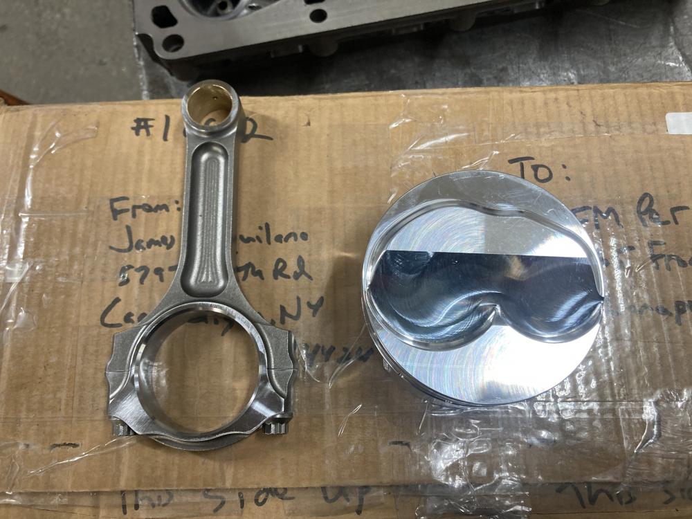

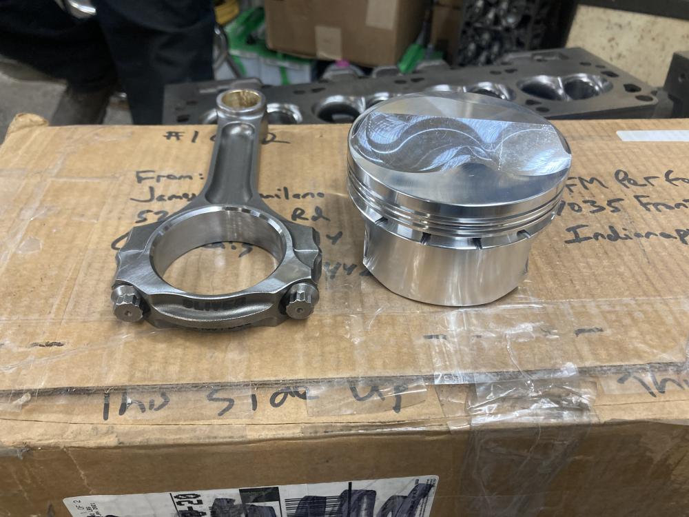

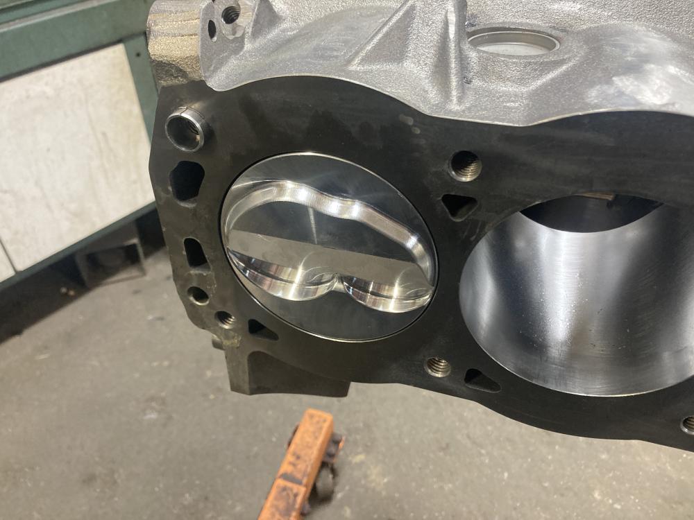

The crank is installed and one piston test fitted. Using Oliver rods and custom pistons from Diamond. The engine builder contacted several sources and Diamond was the only one who could manufacture them in any semblance of a reasonable time frame. The lightened crank was pretty spot on for balance and all that the engine builder had to do was lightly grind two areas on the counter weights and the crank was internally balanced.
The engine builder is going to measure the volume of the heads, test fit the heads for clearance with the pistons and valves (Erson 2.02 intake and 1.6 exhaust) and make adjustments as needed.
