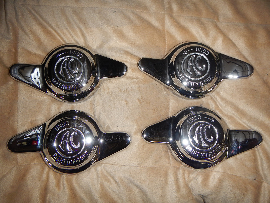

LEFT SIDE of car = Driver's side = RIGHT HAND THREADS (normal righty tighty lefty loosey)
RIGHT SIDE of car = Passenger side = LEFT HAND THREADS.

Mike. I carry a copy of this in my car.
Greg
