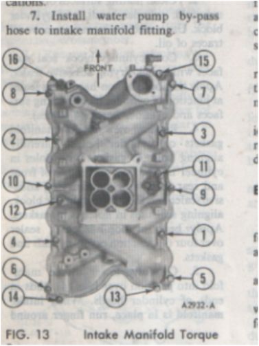

Does anyone have a diagram or sequence for torqueing the intake manifold for a FRP crate 460? Specs?

I don't have a specific diagram, sorry.
The way I have always done it is to start in the middle, then to the other side, criss-crossing with each bolt and working my way towards the outsides. That way, it irons out the gasket from the center out. Do it in a couple stages too.
That's how I do it.

And then keep at it! Alloy intake manifolds need to be retorqued on a regular basis due to the expansion / contraction factor's. Alloy heads/blocks compound the problem. While the Ford torque figures are around 30/35 ft lb for the 3/8" bolts and 20/23 ft lb for the 5/16 bolts, most alloy manifold / head manufacturers recommend a lower torque value due to the softer metal and expansion factor. Check with the techline of your manifold/head supplier to be sure.

Ray...here ya go...Final torque 25 ft/lbs with aluminum heads

Thanks Tony!
I'm trying really hard to hold back on calling Carl's Ford Parts for that twin 4 BBL kit...
And thanks, Larry, JacMac. I guess that's what happened, I never re-torqued and the problem started happening when she hit 4900 miles on the odo.
