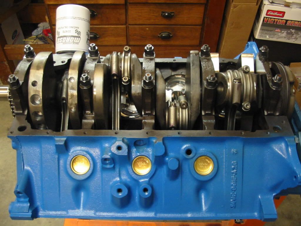

Ok, here's an update:
Short block is finished. Plan to finish assembly Monday/Tuesday. Dyno day is Friday the 22nd.
Custom Diamond Pistons, 4.420" Bore, 13cc dish.
Lunati Forged Crankshaft, 4.300" Stroke
Diamond Pistons/Scat H-Beam Rods
Stabbing in the cam...
Setting the crankshaft...
Tada...
