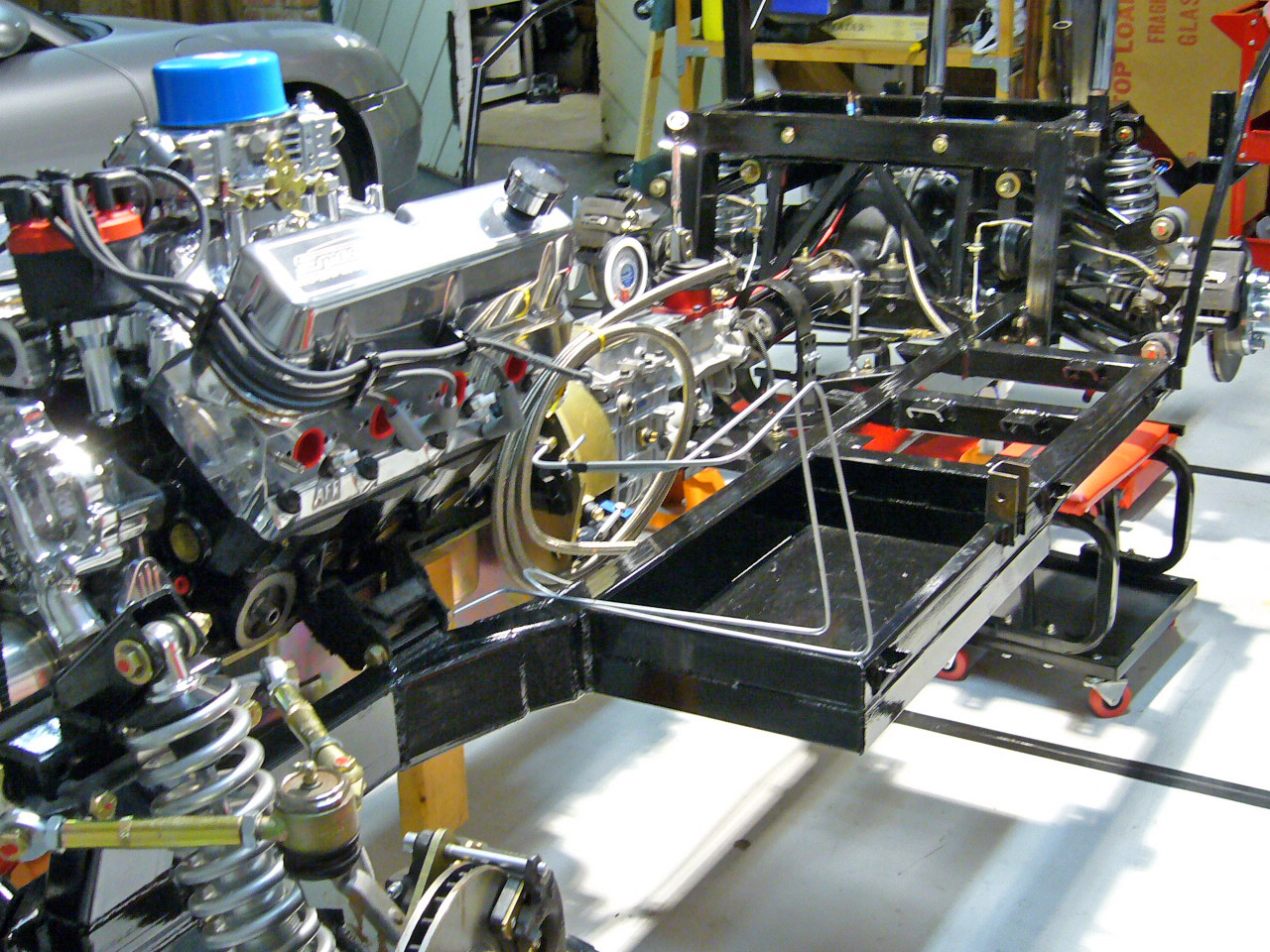

This is a Hurricane kit, NOT Hunter. Every kit has their own unique mount location.

Thanks, Your picture gives me a good starting point.

It depends a lot on what kit you have. FFR's mount the engine more to the rear while others mount it more forward.

My mistake. I quickly read that as Hurricane, not Hunter. My picture is a Hurricane kit and Roscoe is 100% correct. You need to find a representative of the Hunter kit to determine the location. I'll edit my post above.
