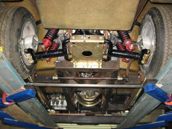

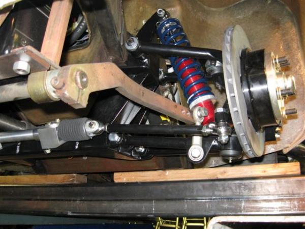

Thanks Doug, Nice setup. Mine is from Stock Car Products. http://www.stockcarproducts.com/susp21.htm
1" X 48 spline. My plan is to set this up and try it and either have it ground down by them to 7/8" and try it and further diameter reduction if it's still too stiff.
I would love to have it installed where you have yours, but I have conflicts with body clearance and the arms. Just too tight. I probably could fit the stock Jaguar sway bar without issues, but I like the option of tuning the diameter of of the Stock Car one to get the ride right.
Right now the only feasible way I have come up with to install the bar is to drill a 1 1/4" hole through the chassis main frame from left to right. That involves drilling through two 3" x 4" main frames and two 2" x 4" cross bracing frames. Then insert a chrome-moly tube 1 1/4" od through the chassis frames and weld all framing members to the tube. The sway bar will then slide through the tube with MDS bushes & stop collars. The splined aluminum arms will then connect similar to yours.
I have the same sway bar system on the front of my car and like the system a lot. My photos show the installation with steel arms that I used as a template. The finished arms are aluminum.

Yes I have a front Sway-Bar. It is the one that Stock Car Products sells
1" diameter x 48 spline. My Gallery photo shows the mock-up installation with the steel arms. The finished installation has black anodized aluminum arms.
My bar has been reduced down to 7/8" diameter. They (SCP) will custom grind the bar to whatever diameter you want. The spline ends where the arms fit remain unchanged as does the 1" diameter areas where the pivot bushing fits.
I'm trying to make the same system fit the rear of my Cobra. So far the only viable solution/location is to drill a 1 1/4" hole all the way through the frame from left to right. And If you seen the well engineered Butler frame, you'll know that I have a bit of hard work ahead of me.
Arthur

It sounds like you're making work for yourself Arthur. I would use adjustable length arms before I'd grind the bar diameter down. I would say a 3/4 rear bar will complement your front one. Look at the option Joyridin was talking of going under or over with it. As long as you keep the arms close to level on the ends at ride height it's gonna do its job.
Drilling a hole all the way through the chassis is work, you're right. But I really like the 48 spline system from SCP with the ability to get "any" diameter bar. And I already have the bar and alu arms for the rear. This is a work in progress and if I discover another/easier way I will take it mate! If you look at the picture you will see the bar running under the chassis. This reduces ground clearance by 1 5/8" at the bearings and that measures 3 3/8" inches to the road surface.
http://www.clubcobra.com/forums/pict...pictureid=2553
So with a name like MickMate do you have any connection to Australia?
Arthur
Wow..mine looks nothing like this. There is NO ground clearance issue with my bar where it is mounted.
