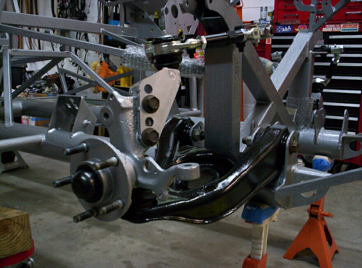

Default picture attached i think
hub and rotor are separate. if you cant see pic here you can see them on my page, profile, whatever...there are three pics there. thansk so much as always for your help.

It looks like you have spindles from a '93 or earlier mustang. I would highly suggest upgrading these at this time to the SN95 spindles that give you more options for wheel/tire combo's. Just do a search on the interweb's and you will find plenty of info. Also do a search on that other forum (ffcars.com) and there is plenty of info there as well. If you don't want to upgrade right now, just get ball joints for '87 - '93 fox body mustang.

You should post this question on FFCars.com - the ball joints are NOT mustang - some chrysler corp joint 0 the are installed in the spindle adapter (thingy with two large bolts in pic)

That spindle adapter is Mustang - here's mine -
I know some do use a Chrysler ball joint to make it easier to replace, I found the mustang one's to be just fine. But you're right, probably do better with a search on ffcars.com

Fox Mustangs don't have upper ball joints. The upper on those control arms are a scew in Chrysler part not Mustang. The spindle adapter is a custom FFR piece, not Mustang. Make sure all your ball joint to spindle washers and castle nuts go back the same way.
TRW #10162 or Moog #K-772 for the ball joint
Summit Racing # ENS-5-13102G or Energy Suspension #913130R for the upper and lower dust boots.

Also be aware that if you choose to upgrade to SN95 spindles you'll need to get new spindle adapters from FFR. The SN95 mounting holes are in a different place from a Fox spindle. The new adapters accomodate both styles, but the picture you show only has one set of mounting holes and thus won't work for an SN95 spindle.

No, hub and rotor are one piece. That's fox body stuff. The picture CoryB posted shows later SN95 stuff.
