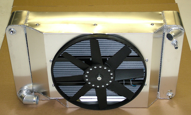

i swapped out my radiator and twin fans for a black magic fan and made a custom shroud
